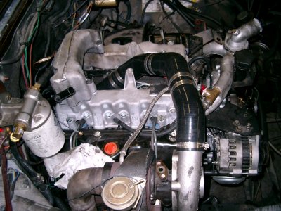

here's some pics of how much of a difference they are. the first one is the pickup style from 91-94. the second and third pics are the late model hummer/van intake.

you can buy a bare block ($1800-2000 for the block, ebay) and heads ($600 for new casting from Clearwater) and use used parts for all others but 6.5 parts are cheap so you may not need used...... the 2000 and 2001 (pre-duramax) used the navistar block and it can be fitted with a DB2 pump. I put one in my 91 2500 'burb to replace the tired 6.2 and ran an SS diesel supply rebuilt 6.2L pump and used an electric lift pump from a 95 to replace the mechanical LP..... a few other mods and it was a powerhouse. not on the level of a modded 7.3 turbo or a powerstroke but it was fast ......'specially with the 'burb's 3.42 gears.
