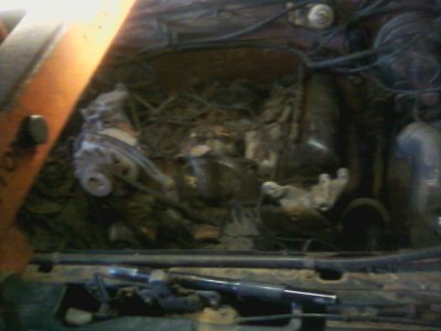

Finishing putting the truck backtoghter
Two quick questions. I don't quite rember how all the front acsserios go on. Order exatl placement of bolts etc. Does anybody have a write up or something of putting them toghter? Pics would be quite nice.
Two. Installing new set of injectors. What's with the copper rings? How dot those get installed?
4 injectors came out with them stuck to it and 4 are sitting in the bore stil?
So...? Confused on howthat goes toghter.

put some grease on the end of the injector that you took out.shove it back into the holes that have the washers, they should grab them if not. Go fish with a screwdriver just be careful. When you put new ones in put the washer on the injector and use some grease to hold them to the injector so they dont fall down inside. Or you can drop them down the hole and use a screwdriver to get them flat.

Ok so injectors will be easy.
But stilly foggy on the front. Ac alternator fuel filter housing and everything on the passenger side.
Im 99% positive I have the drivers side tho.

Pass side top=ALT
Pass side bottom=Vacuum Pump
Drivers side top=AC Pump
Drivers side bottom=PS pump

Those front accessory bolt/brackets can be a PITA to figure out. I've learned to just remove them intact with each bolt in it's location and leave them there until install. Much easier when everything is where it needs to go when it's time to reinstall. The 1st time I pulled those off, I put the bolts and brackets in a pile.........Mistake.LOL Took forever to get them back on correctly. Never again.:D

Got the heater core line fixed. Return lines fixed today no more leaking there.
Got to run her more than ten seconds this time. Got about a minute until I noticed the wiring harness that goes acrros the fender well by the passenger battery. Just great...
Gonna tinker with it and see what happens.

Ok that spots fine.
Now I just burnt the connector on the glowing wiring harness right were the two big yellow wires for the power are. Seems that's common tho.
