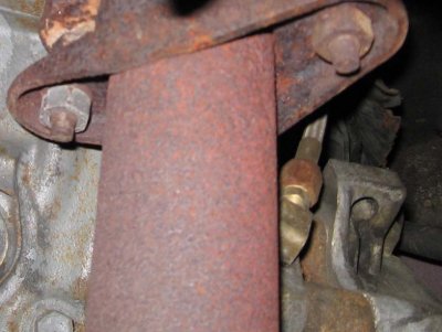

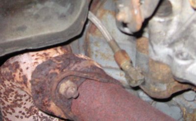

Where is an easy place to access to put a sending unit for an oil pressure gauge on a IDI?... Should I try to use the stock location? I'm putting a tri-pack gauge pod on my dash with oil PSI, water temp and probably a Pyro. I want all the factory gauges to work as well.

There is a port on the drivers side of the engine. It's down near the oil cooler at the back and has a 1/8" NPT thread.
