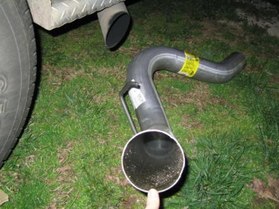

NAPA EXH 54387 is 4" exits out at about a 45 not a 90 like is stock I put it on mine last week and looks great just need a tail pipe for it because its short so I just tacked on anther piece of 4" so it comes out the side.
If you want a pic I can get one.

ok, where is the pic? It's almost 10am for crying out loud! :)
exactly 10am when lucky people these days are at work;Sweet
Anyway thanks for the reminder I might have forgot. Here you go
Like I said the tail pipe is short and wont clear past the bed side, so for now I added what left of 4" I had till I get a tail pipe. You will need about an 18" one.
