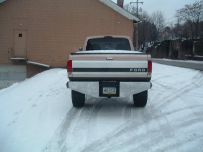

on mine I had a hole cut where the liscense plate bolted, and the hitch went throough there. I believe it was the same on the truck it came off of.
the plate was higher and the reciever was right under it
when I moved the bumper up to match the body lift, thn I had to notch it, I notched it to fit around the hitch, then welded it to the hitch the liscence plate now is over the old hole
here is a pict
bonus point if ya recognize the bumper
here is a pict
Big Eds bumper.:love:
I sooo want one of those for Goldie.
