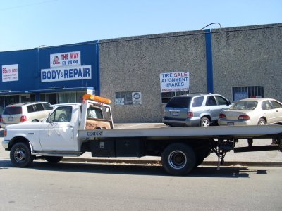

Hey TowCat....Thanks for the advise....
19' Century Aluminum on the Superduty and a Dynamic BSW SelfLoader W/ boom on a 96 C3500HD.
