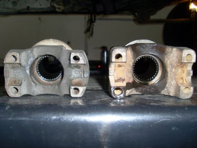

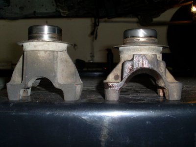

Howdy ... Which transfer case did the yoke come from ..... 3/4 and 1 ton t cases are both 1356, but the ones with the PTO provision had a different style of spline from what I was told and the yokes aren't interchangeable
I didn't encounter the spline difference issue you mentioned when I did my truck.

The spline diff is between the 13 series cases and the latter 4407 cases in the powerstroke trucks 95 1/2 and newer.
