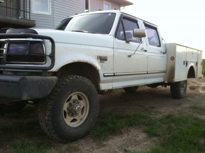

I've got a line on a '94 2wd DRW parts pickup. Now I don't see a lot of 2wd's in my country. The rear axle should swap straight into my '94 4wd F350 to convert to a dually as far as I know. What about the front axle adapters? Will they bolt on my D60 front axle or will I need something different. Also I'm sitting pretty heavy at about 12K when fully loaded and the brakes really aren't quite enough. What are your opinions of rear drum or disc conversions? Is there a stopping improvement worth the disc conversion? I run a lot of bad gravel roads (I got 17k miles out of my last set of TOYO M55's) and the drums are a lot better protected from the rocks. Since I did my hydro brake conversion my brakes actual application time is really delayed if I stomp the pedal in a panicked stop. So, I need some opinions on the rear disc's and what the issue with my hydraboost is. I suspect my rear shoes could be loose and that my possibly be the cause of my delayed braking feel.

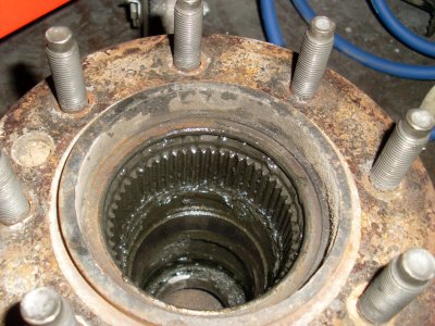

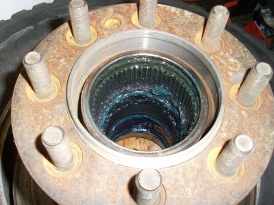

the pickup dually axle is a drop-in.
either oem dually front hub or srw to dually adapter will work. the location of the wheel is not changed either way.

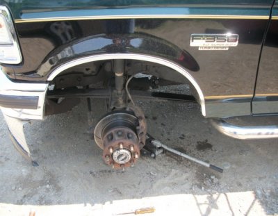

there is one very good (and possibly better than oem too imho) to front dually adapters.
here is what i used to convert the front of chip truck.
quality grade, hub centric front adapters made by arrowcraft.AA-4 series.
