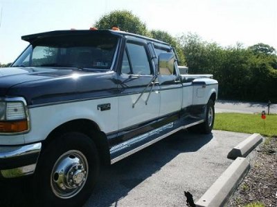

As mentioned, apextrans got some "bling" added to my 'boards. He stripped the clear coat, machine polished and then hand polished the diamond plate. :hail ;Sweet

I just commented on this on your other thread...Looks great Joe! What did you use to polish the diamond plate? Everytime I start polishing diamond plate I get frustrated with all the bumps!

Man, I never got to see 'em in the daylight. They look pretty bright in the pictures though. I used aircraft stripper to get the clear coat off. You can get that stuff in any auto body supply store & maybe some auto parts stores. I use a dewalt polisher running between 1000 - 3000 rpms with a Keystone yellow starched fabic wheel & (depending on how bad the aluminum is scratched) either a grey, green, or white tripoli polishing compound. They are big bars of abrasive rouge. The different colors indicate different levels of abrasiveness. Grey is pretty course, white is the least course. You can get tripoli bars & polishing wheels in any big truck stop. Once I got the clear off, the boards were in good shape so I went right to the white bar. I tried some of the more abrasive bars but they were doing more harm than good. The trick is firguring out which way the grain of the aluminum is running & polish with the grain. If you go against the grain, it puts more scratches in than you have when you start. It took some time to figure that out on diamond plate. I really would like to redo some of what was done the other nite because I didn't figure out the grain until the last board. Once I finished with the polisher, I hand polished with a liquid polish & buffed off. We didn't do that on all the pieces, but it is a good idea. The only clean rags I had were too rough & scratched the aluminum. Be sure to use soft rags for buffing.
I still have to do the other side of Joe's truck & now know what the best plan of attack is so it should go a little quicker & look alot better. When do you want to finish up Joe?
I don't think I will be able to attend the ralley but maybe I could write an article or something. If you have more specific questions, PM me & I'll try to help you along.
