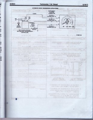

Here is some more about the circuits.

I am looking for the easiest way to get a RPM signal.
You already have the signal. The E4OD computer doesnt work without it. You just need to attach a wire/pin to the output. On the vans the wire just isnt there like it is on the f series but the output/computer is the same.
