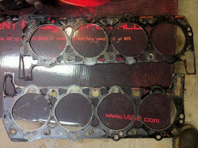

Ok well today I decided to tear it down instead of trying to hunt for fittings to use compressed air... I've been Driving it here and there and decided to drive it to work today got to work and it started to smoke pretty good so I shut it off worked 4 hour came out and it was hydro locked...... So I pulled the glow plugs and got the water out of 2 cylinder (pass side rear and drivers side front) is it odd those 2 had filled up? Did so and go it fired up.
I assume I could see cavitation if that's what's going on? Even tho the head gaskets could be bad still.

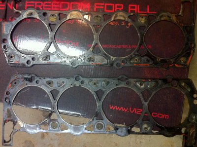

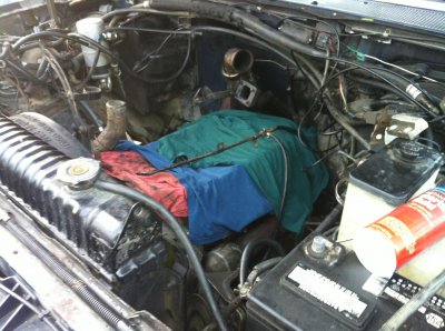

think i found my issue...
pulled the heads yesterday and today.. if it didnt have the banks turbo it would have been done in one day but man that thing is a pita to remove...
the gaskets are toast... so ive looked at the cylinder walls and i dont see anything that looks out of the norm... would i see the cavitation if i also had that on top of h/g failure
