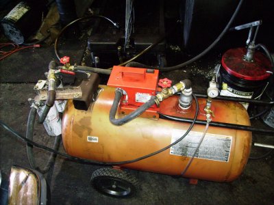

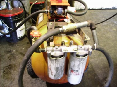

i spent about 200 dollars on my set up but i bought a gear pump from nothern tool that was about 170 but im going to be replacing that pump someday and mounting that pump on a tank in my truck bed

I haven't really spent much on anything. You can throw wmo into your tank and run immediatly on it but it's necessary for the longevity of your truck fuel filter(a very expensive filter) that you filter the wmo as well as you can before you load your tank with it. I've designated a tank for wmo usage and am installing a filter unit on that tank's fuel line. I let the wmo that I get settle for a while in a clear container so I can remove any water possibly contaminating it. I then pour the wmo through a cotton sheet to remove large particles and fill a 55 gal drum with the wmo. Then I'll pull the top 40 gals from the drum and run the last 15 gals through my process again. Then I'll pump the earl into the tank with an electric pump pressure forcing the wmo through another fuel filter.
