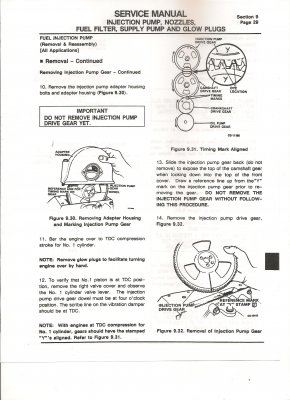

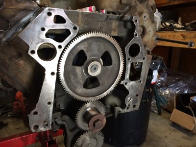

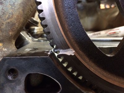

Sorry to hear about all this. I know where you are coming from, wanting to get it right. The manual shows drawing a line on the IP gear, and I can see that working. Now how do you know where the timing mark is on the cam gear? I have heard (Urban myth possibly) of using a dental pick to find it. Might be worth a try. This guy on FTE used this method to verify the timing marks. I would try it on something other than your engine first. I wouldn't want plumbers putty ending up in my oil pan or between my gears. http://www.ford-trucks.com/forums/1113735-aligning-the-pump-gear.html
Edit: I just had another thought. I have seen a mirror used to reflect sunlight to illuminate areas a flashlight wouldn't. Maybe you can see in there that way. I just hate the thought of you taking everything apart.

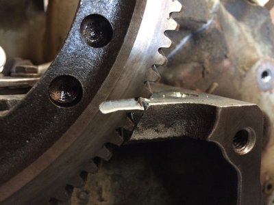

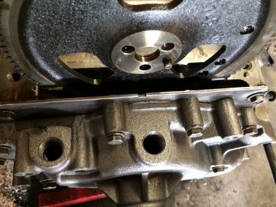

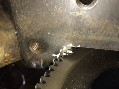

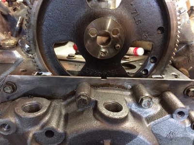

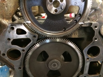

Pictures
I used Gary's pictures and the 17 tooth rule and plain sight to set these up. Hope they help! A bit easier with the engine out but you'll manage.

We had a guy show up at a timing clinic once. He was way off, and we were surprised it ran. He popped the gear housing off, and moved the gear back and forth, with me checking the timing, to see if he got it close. It took like forever, but we did eventually get to the point where we felt we were within 1 tooth. I timed a different truck here at the shop that I was able to get in spec, but the pump was leaning way over towards the drivers side. He had some unrelated engine problems later, and told me it was 2 teeth off.
