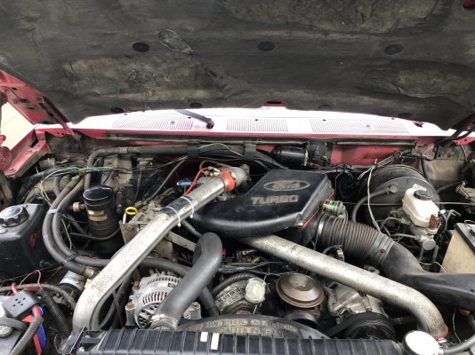

I have a snow performance water/**** setup in my truck. Egts noticeably cooler when it’s going. Don’t know if I notice a power increase or not.
takes up a lot of engine bay real estate the way mine is installed.
Bad photo here I’ll try and find the video I made. Pump and reservoir far left behind the battery. Red hose sprays into the intake.
Happy to answer any questions
