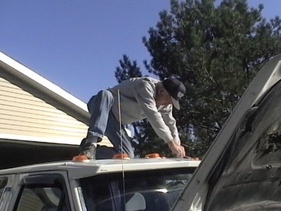

You talking about a Lund Visor like this?
The screws holding it on are threaded into, IIRC, the 1/4", Oh hell can't remember the name of them. You know what I mean.
Welding the holes up, your surely gonna set the headliner on fire.
