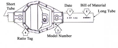

Twisted off the yoke on the end of the right side intermediate shaft on Dog (the '86) while I was plowing snow today. Can't find the axle ID no.# to see if it's a Dana 44 or a Dana 50. I transplanted this axle out of a 90 F250 7.3.... Ford can't tell me by the VIN of course. Are there any sure fire ways of identifying a 44 from a 50 without pulling the diff. cover off? And I need the shaft ASAP. We have snow now and more on the way in a few days. Anybody got any ideas??? Are the axle shaft a smaller diameter on a 44 than a 50 and if so, What are the measurements? HELP!!!!
Hoss.... :dunno
A Dana 44 diff cover is 10 3/8" wide and the Dana 50 is 12 1/8" wide and the model number should be stamped into the differential casting.
