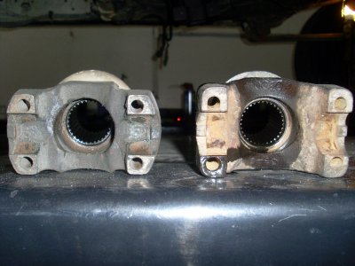

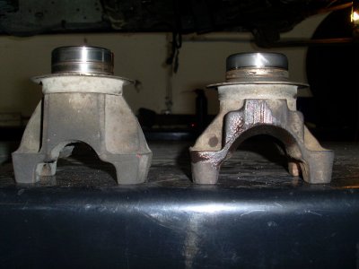

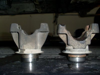

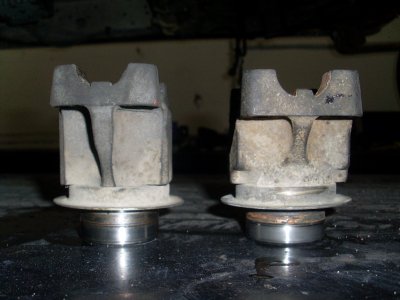

*IF* the F250 and F350 have D60's under the fronts, they are the same.
otherwise, they are very different. see pics. in all pics, the yoke on the right is for D60 the one on the left is for D50.
