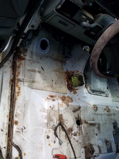

Here is a picture from a 1993 that was a ZF5 and 4x4. I assume it had the same transfer case. I can get dimensions for you tomorrow.

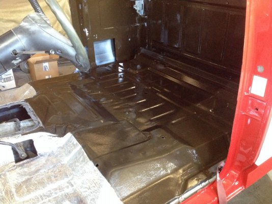

I couldn't get any pictures from the '89 as I never pulled the 4x4 shifter after I wrecked it. Ignore the nose, my dog had to investigate what I was doing.
These are from the hack job where I cut the hole in the '84. The hole along the top edge of tape measure is the first hole from the back.
This is a half ass picture of the size I made the hole. Never had any issues with shifter clearance.

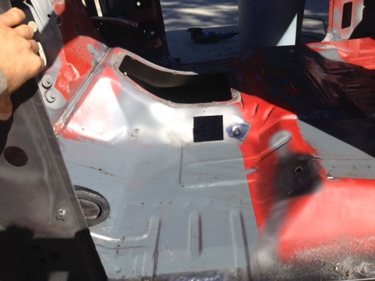

I never recorded any measurements but here's a photo of the hole I made for my conversion. Note that this is a 1986 style truck with the newer 87-up shift linkage. I rather like the setup because I can pop the shifter into 4H with a nudge from my boot. Couldn't have done that with a period correct 80-86 style transfer case linkage. The shift boot is also the same going right up to the last of the manual shift superduty trucks, so you can still get new ones. Hopefully you can get a general idea by going off the stamped features in the floor.

Thanks for the info - love the pic of your dog peeking through the floor!!!
