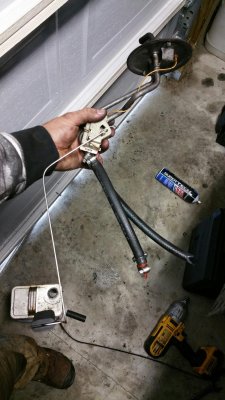

The orange part is a back pressure duck bill check valve that can fall off too and drain the return line. Where i have the rubber line clamped and cut like a reverse fish mouth is what you can do to replace a failed shower head. This is the sending unit i extended for my 38 gallon rear tank.
I still think you need to invest in a cheap electric pump, gas rated is fine, then run it from a can and see if it runs. It'll suck full from the can and return it to the tank, so if you want to run it for an extended period of time you need to route the return line back to the can too. It would take you less than 10 minutes to do this and eliminate your tank, lines, pick ups, senders, filter, and fsv from the cause. Then you can gradually connect the rubber line from the electric pump to varying parts of the system until you find the culprit.

They claimed the aftermarket tanks they put in were the wrong size and that's why it runs outta diesel at 1/4 tank. Sounds iffy to me. I can fill it up waayyyyyy past the full mark on the gauge though, it's like the needle is just in the wrong place.
Either the showerhead (pickup strainer) has fallen off, or the sending unit is way out of adjustment, or perhaps it's the alignment of the needle. When it runs out, and you refill it, how much fuel does it take?
Is this happening on both tanks? What size tanks are they, according to "them"?
On the shower head is a orange color suction valve that operates only when the suction strainer gets plugged up. So tanks have water in them and freeze up stopping fuel from being sucked up. Thats when the higher up suction valve will suck open and allow fuel to get to the lift pump and then filter and finally the injection pump. As already posted. The 5/16 return line in the tanks does have a duck bill valve to keep the return fuel from siphoning out when the engine is shut down.

18-19 gallons, in the front and and around 15-16 in the rear which is about the same as my half ton with two tanks. PO couldn't remember how big they were supposed but the aftermarket smaller tanks was what they said when they warned me about running out at 1/4.
I'm gonna go run around town and see if I can't find some clear hose and a cheap pump.
