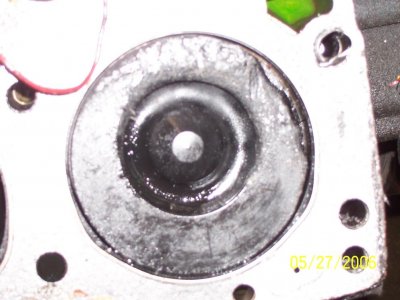

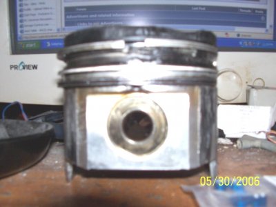

This is why you dont use ether on diesels!!

I'm with Russ, that's a ******* injector causing a hot spot. It's called streaking.
piston outof my first PSDs replacement engine.had a fuel knock/drippy injector from a cracked nozzle.not 1 drop of ether was used in that engine

Ether will break **** but it won't do that....Type4 is right, that's EGT's at work - severely over fueling. I've seen some gasser's melted down with nitrous that look like that.cookoo
