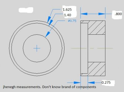

@rwk made me a very nice Delrin bushing based on mblaney's measurements but I didn't measure very well so it didn't fit perfect. (not his fault, all MINE)
This is a picture showing my new measurements which I took and re-took and triple-checked this morning. I'll work to see if I can get this one made :hail:hail

Cool, less stock to turn down, measure once cut twice, right?LOL
I'm the carpenter that cuts a board 3 times and the darn thing is still too short:dunno
That's why I like welding. Stuff is easier to make it longer again :rotflmao
Sent you a PM too ;Sweet

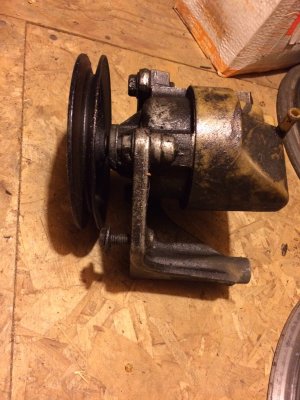

Brief sidetracking to provide some pictures for @rwk for a related steering project. Can't send pics through PM...

thanks for trying, need 2 groove ps pulley,going to try to straighten mine first, then look for a used one, anyone have a spare to sell?
