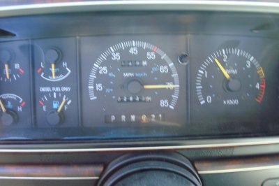

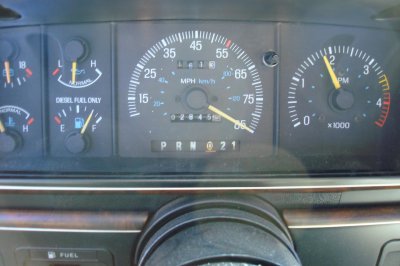

Thanks for the informative information on what you are planning. Also pleased that some ebay seller is helping you along. I'm really not sure but I feel the pump designed in the 30s or 40s is not the pump you are working on today bu I aplaud you for risking what you are doing. Sometimes we learn be opening something up and having a look. When I purchased my truck in 94 I only knew it was a diesel. I could not change a glow plug or an injector. I had a shop do that and they really screwed me over on the parts. They left in the back cylinder hard to reach glow plugs and installed autolites in the easy to reach cylinders. The back 2 were champions. When they burned out I figured I was going to learn how this was done. I learned fast too. Good luck on your plan. you have more faith in yourself than I have in myself. Injection pumps are a speciality item I leave to those that know. Money well spent is just that for me. Well spent. I realize there are cheaper ebay choices for injection pumps but what I have run for many years works very well for me. An owner can't know how much better something is till they ride in my rig. I do have plenty of "work" done on my engine too but it pulls well in double over drive too.
