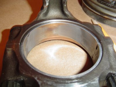

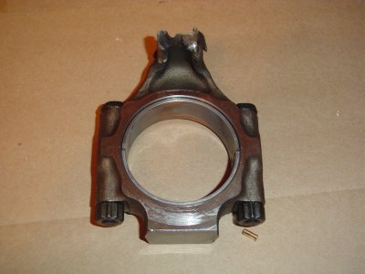

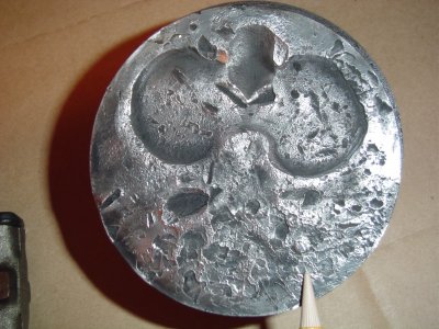

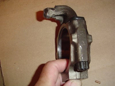

Those pistond do not have valve contacts in the middle. We do not have a valve in that location. As Russ suggested. ALWAYS pull the pan on an engine you did not hear run. I too was screwed by an ebay seller on my idi engine. I paid 88 bucks for a stripped engine he pulled cause of high miles going back and forth to mexico home. It was on the upper desert open and dirty as hell. Because I was building a turbo engine I could not care less about rain water in cylinders because they were to be sleeved. Sure nuff most cylinders wet and rusty but.. With both heads off and me hand cranking the engine to clean out some sand and rust the engine locked up. Turned it backwards and same thing. Then noticed cylinder 5 piston not moving. Well this kindly little hispanic liar had thrown a rod and felt he got me good. But nope... Got it apart and found not crank issues nor any cylinder damage. So I sleeved it and am still running same engine. Another member here way back then said I should go back up there and thank this little guy for a great engine. Tell him all I did was clean and paint it and here it is. I passed cause I don't get over being cheated very well. Here is a pic of the rod as I found it on the crank.
