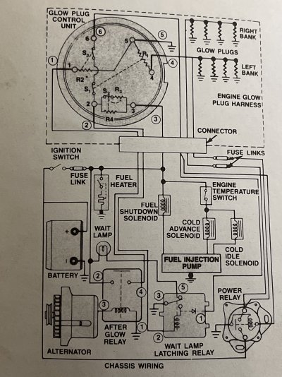

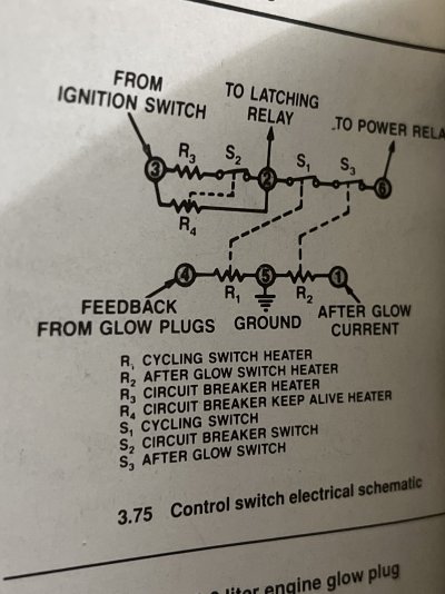

I have a chassis wiring schematic for a 1983 to 1986 glow plug system.
I see there’s a sequence of events. There’s numbered segments. There’s vague (to me) wire paths. There’s labeled components.
If I open up a hood I could point out and replace a harness, an alternator, a starter solenoid, a starter, etc. But my brain breaks when I look at it diagramed out. But I’ve got to figure it out because not understanding how to read these things really holds me back as a shade tree mechanic. I can’t diagnose and troubleshoot nearly as effectively until I do.
I’ll pursue YouTube for good videos to help explain how to read these diagrams better.

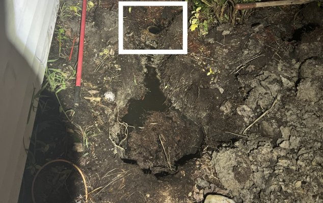

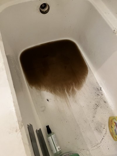

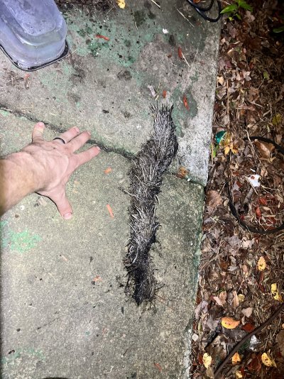

Didn’t get to glow plugs and injector lines like I wanted to today. The plumbing had other plans and Sewage backed up into the tub.
So I found a sewage clean out (on the house side, not the city side) and ran the worlds ********* 1/2” drain auger through the clean out.
After I pulled out gobs of toilet paper, hair and ****, I finally reached the root of the problem by finding actual roots that grew into the sewage line and blocking the sewage drain. I must’ve pulled out 4 different balls of roots just like the one pictured. The one pictured is about 16” long!

Roots sense water through the old clay pipes and home in. I had to that every year or so, in my last house.
