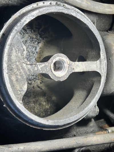

I noticed that the intake manifold has a ton of mud and debris on the inside, so I think the intake should come off before that debris gets sucked inside.

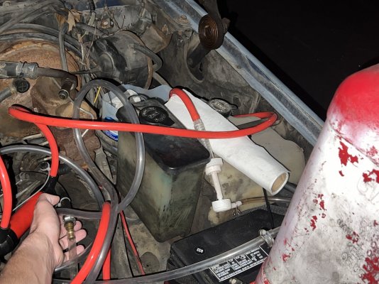

I would bypass the fuel tanks for now, run it out of a jar or bucket of some sort. The tanks may be full of garbage. Had that happen on a 1988 my old man and I picked up dirt cheap not running. New tanks and she ran just fine.
That’s a good plan. I went ahead and ran a clear hose fuel line from a diesel can and it hooks up to the steel line that wraps around the back of the motor.

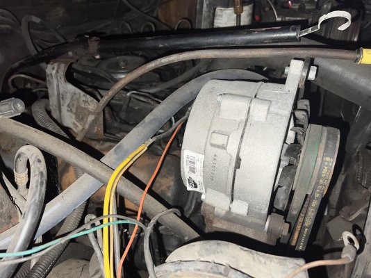

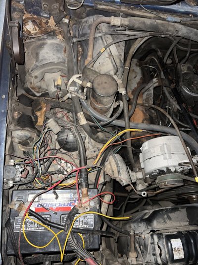

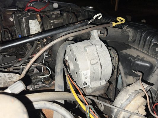

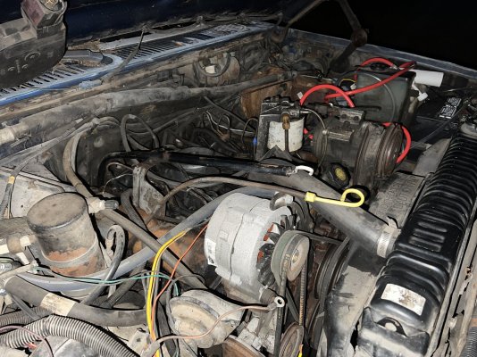

So the previous owner used the "solid state" system from the 88? I would have left it as it was with the old style, oh well. Post a picture of the alternator if you can. If the previous owner was that excited about putting in a different glow plug control he may have done a 3G alternator upgrade, that's a pretty common thing and it's internally regulated.
Here’s a picture of the alternator, the existing wiring, and the missing voltage regulator and 2 relays on the passenger inner fender well.

Yeah, that's a regular alternator. The solenoid on the side wall is for the starter, the one above the tire is for the glow plugs. I thought it looked like you had the solid state controller but it looks like you have the old style glow plug system like is supposed to be there. It really sucks cleaning up wires!
