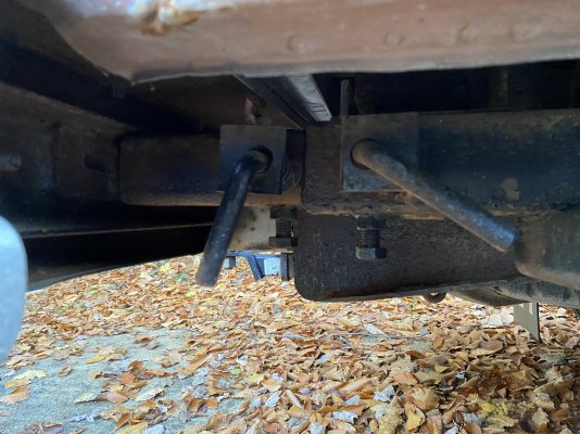

My truck has some square tubing that sticks out the side of the bed. Underneath. I guess they are tie downs for an in-bed camper. Today I noticed that my rear bumper has some pins. Would this be to remove the bumper for the camper or is it OEM and serves another purpose?

Certainly looks that way, that's not the factory bumper supports in there.

My guess is it's for a camper where the hangover the bed goes further down than the bumper. Must be a very specific application, cause my camper fits on just fine with my bumper right where it's at.

When I put my cabover camper on my '86 I had to remove the rear bumper. Otherwise a holding tank would hit the bumper. The only other option was to place some plywood in the truck bed to lift the entire camper enough for the holding tank to clear the bumper.

There was a model year change at some year with Ford (I don't remember the year) where the cab apparently was made taller. People with older cabover campers had the problem you've described.

It could also be a “slide” for the rear bumper. Lat’s say you have an 11’ Camper. The bumper would be 2+ feet in front of the rear of the Camper. You might be able to pull those pins, and slide the bumper back to another set of holes, and then the bumper would be even with the back of the camper. I know that IH had something like that for the camper special packages on the IH Pickups….
