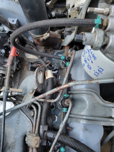

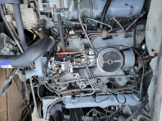

OK. Got some time to work on my truck after work today. Added new showerheads and floats to the tank. Fuel gauge still doesn't work, but I think I'm getting fuel to the fuel filter now (more on this later). When I put the key in run, none of the dash lights come on. Wondering if that has anything do do with fuel gauge not working. Hopefully I can look into that more this weekend. The main thing I'm worried about is what appears to be pretty massive fuel leak on the first three injectors on the left (passenger) side rail. Fuel lines on the right are cracked, but bone dry. Left side has fuel sitting on intake (see pictures). I think the fuel is coming out the bypass, going to the left cause there is a return path (right side dead ends at first injector) but return nipple hole is very small so it can't all return there and leaks from return line orings. I've attached some pictures (one big picture so you can see line routing, and a close up so you can see the leak). It's a newly remanufactured injection from a Statadyine authorized and reputable diesel shop in west sac (Diamond Diesel). I actually think they are rebuilt in Oakland and shipped back to west Sac. Anyhow I digressed. Here's some pictures (following to get more detail).

Here's top view. BTW, I have power at the two tabs on the injection pump when key is on in case you are going to ask.

Here's the close up. If you look closely, you can see the leaking.

One thing. Not sure if it's normal but ther is no return to tank like on my 86. Looks like there is a plugged off fitting. See picture at the back the tee is plugged. I think it can be a 4 way. This is the way it was routed on the newer doner truck (89?).
3,294
3,748
If you haven't already, you basically have to replace all the o rings and return lines or they're going to leak. It's inevitable, if the rubber sat for any serious length of time like yours has they leak. Your engine looks clean though.

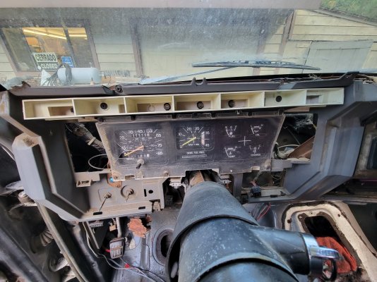

Pulled the dash. Thought all the bulbs would be burnt out.... but they are not. Guess I need to do more testing... Did I mention that I'm never tearing another truck down like this. Gonna fix a bit at a time and keep it running. To much all at once. It's overwhelming.
