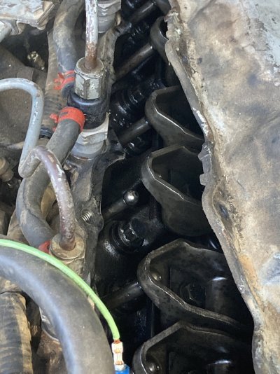

Does anyone run anything else besides stock lifters on your idit?
Found some power stroke lifters with guides for my application or just get some motor craft turbo lifters for my setup .
I broke a lifter and I’m tearing the motor down to the intake manifold to get to them. I believe they are stock off my 91.
Also if someone could tag a link for the IP removal and install I would appreciate it, going to you that search button for that one
