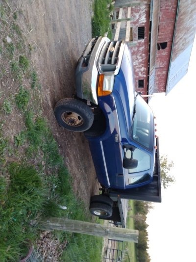

Hey there, this is my first post in the powerstroke section, as I've only had IDIs in the past.
I made the leap to a powerstroke, and while I'll definitely miss the IDIs, am so glad I made the switch.
Only problem worth noting, is it won't shift into L or R unless you do some fancy stuff.
It seems like the clutch isn't disengaging 100%, because otherwise shifts good, and goes in other gears fine .
I'll sort that out, but besides that, I'm really happy with the truck, and low the gearing. Will be a perfect fit for what I need.
Since I'm new to PSDs, is there anything I should check right off the bat while I'm going through it? And things to watch out for?
I'm aware of the cps problems, and plan to keep a spare on the truck.
