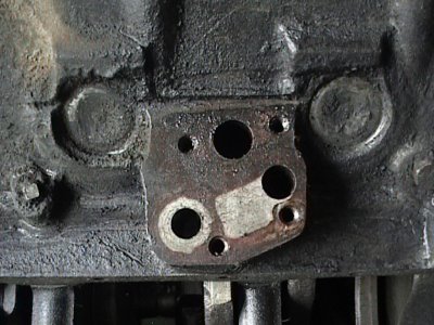

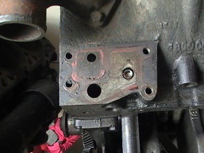

338
I know the fronts are 9/16ths and the tears are 1/2's.
That not right, both header bolts are 3/8", your talking wrench size, but 3/8' bolts take a 1/2" wrench. If the front header takes a 9/16" wrench, someone had to drill and tap for a different size.
When you tighten somethiing down, never tighten the first bolt, just snug it up, then cross snug next bolt and so on, then torque all in same pattern.

The front header bolts are 3/8" and torque should be 24 ft-lb
The rear header bolts are 5/16" and torque should be 14 ft-lb
