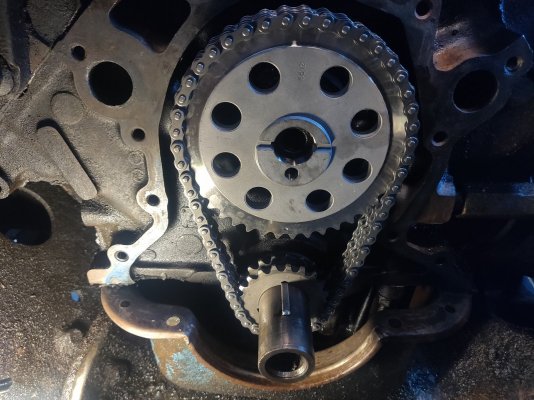

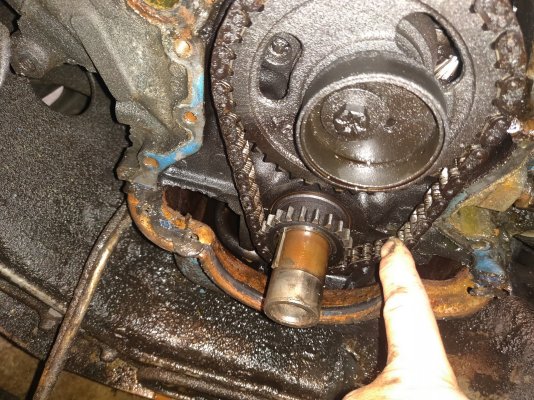

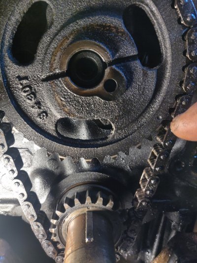

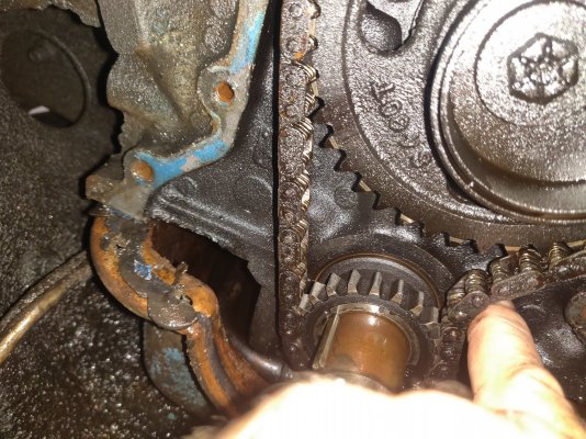

Well, my care package came in from rockauto yesterday, so today I did the 302 deep dive. Here's the problem!

It's only a little off! I had a pretty good suspicion within your first couple posts that was likely the issue. Did you upgrade to the Cloyes double roller?

Yeah man, there was enough slop in the chain that I could have massaged it over some teeth. I'm not an "old man"(42) ,but I've heard people mention a timing chain jump, but I was like "yeah right", timing belt, yeah....chain, no. But you saw the pictures, they're not Photoshop. The teeth arnt worn down like on @Rdnck84_03 s truck he did a while back, it's literally the chain itself is that stretched.

It is hard to believe that any chain can stretch that much. I know miles and heat make things to funny things, but cheap parts really do suck. Think about the fact that for just a few dollars more than that POS the previous owner installed, you can get a quality double roller set that really cannot be worn out. Good for diagnosing it to the exact part that stopped operation, and for upgrading to the bullet proof replacement part. Two thumbs up :Thumbs Up
