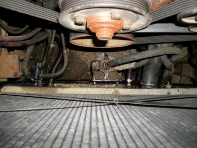

ok so,the hardware came and it's time to start putting chip truck back together.
rad support back in.so the hardware kit was good but it didn't come with the large washers you need.so i had to run to the hardware store and get them.one on the bottom,a very large and a smaller for the top,followed by one more smaller,this way it gets stepped down for the nut.

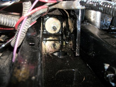

since i forgot to snap a couple pics of the new hardware/mounts i took a couple today;
attachment.php
attachment.php
I hate to say this but your rad mount hardware is upside-down. It should go from bottom up: bolt, large thick ish washer, rubber only bushing then mount then the top bushing with threaded insert then your spacers, rad support, washer and nut.
