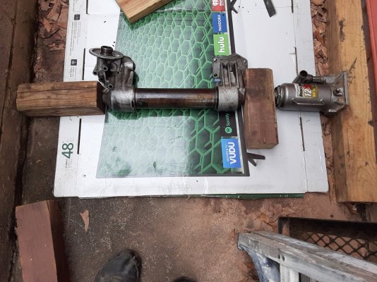

Update: Oil cooler is back on the engine. I had a ridiculous time trying to get it pressed together. I was going much easier on it this time so as not to recreate my cut o-ring problem. It would not go together. Vaseline, motor oil, bearing grease, nothing helped. So, I stuck the tube in the freezer for 30 min and heated the heads up with a heat gun. Went together waaaaay easier. I'd recommend that be part of the install instructions for these things. Jeez. Anyway, now I'm waiting on the permatex to set up enough to torque bolts down, then tomorrow, fluids. I'm thinking coolant first with the oil drain plug out.

Update: All is well. No leaks (so far) from the gaskets, and no coolant appears to be getting in my oil. I'll run it as is for 100 miles or so and change the oil and filter out just to be on the safe side. Thanks for the support fellas. Pic below for those who want to see my shop press.....
Glad to hear it all worked out this time.
I like the Schwenke shop press too!
