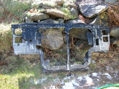

l@@k what i scored in the lone star today!
338
I am just baffled at how that rad support fit in such a small box. But then again everything in Texas is big. Even heard they can get 20 head of cattle in a pickup truck.:dunno :D

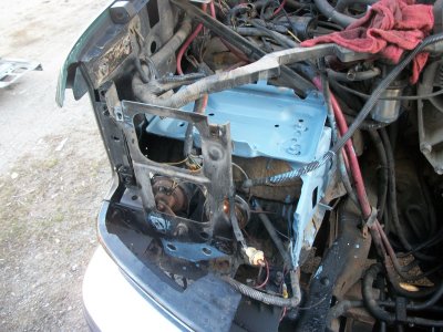

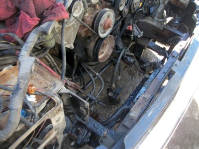

the disassembly continues.........
attachment.php

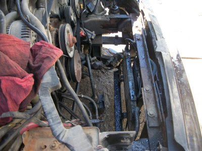

radiator and electric fans be gone!
attachment.php
attachment.php

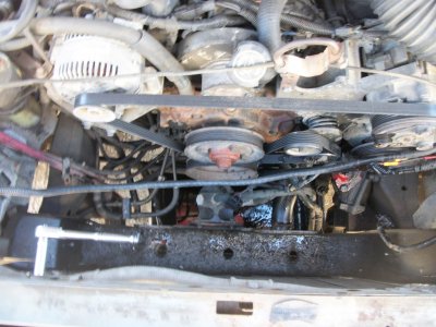

oh my god.so many wires,so many hoses.so many this and that.one aux cooler mount,one hose.one wire after another!!!!!!
attachment.php

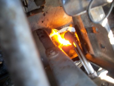

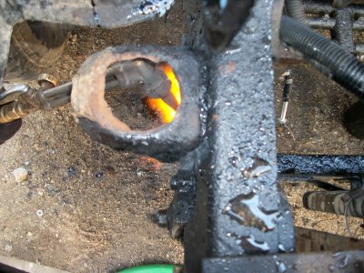

burn baby burn!!!!!!!!!!!!
attachment.php
only had to burn out one side.the other mount was already rusted off and lifted right on out.burned a hole through the lower inner fender on the drivers side,but that's just good for increased airflow.:D
had to remove my aux oil filter mount.
attachment.php
attachment.php

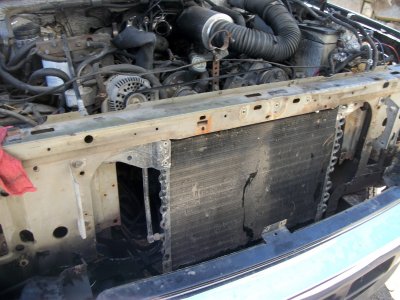

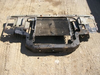

there she be.so you know,not too shabby! she's actually still all good,save for the mounts.someone might want to fix this thing considering how easy it might be to repair.sure i cut out intercooler piping slots and it's got some rust around the edges but that don't hurt much.
left the a/c condenser in.a/c has a leak somewhere (probably just orings) but i don't use a/c.even if i did here in ME those who do use it,only need it for 2 months lol.i enjoy the heat and haven't frigged with the a/c for years so no point in putting this back in.let the air flow through the rad better without it probably.
attachment.php
oh man.finally.what a chore.wouldn't be too bad if you didn't have aux lights,coolers,filter mounts,etc.etc.etc.etc.etc.etc.etc.etc.etc.etc.etc.etc.etc.etc.etc. lol!

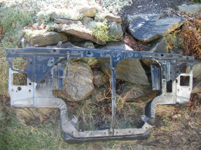

and i'll let the purple power just do it's magic after pressure washing off the bulk while i stop for a cup of joe.......
attachment.php
attachment.php

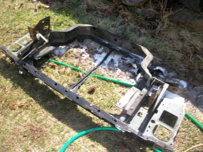

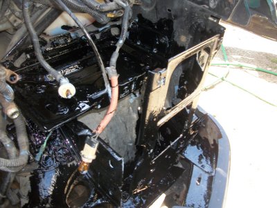

ok washed her down and look i painted it all up already?!
attachment.php
LOL! if i didn't tell ya you might of almost believed me.amazing how clean stuff stays out west hey guys?
so i'll let her dry while i have another cup of coffee.......hey,im liking this part after the hassle of ripping that rust one out!:D

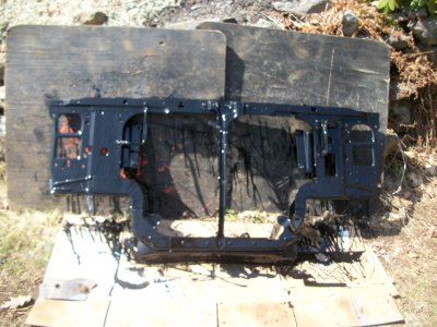

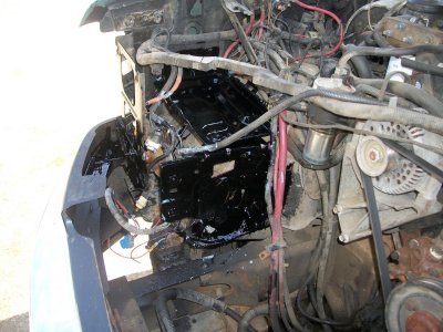

ok.sanded and primed a few touch up spots that needed it.i was gunna get the compressor going and fill up the spray gun,but then i thought,why? she hasn't gotta look pretty.she just has to be coated so i grabbed the brush instead.streaks ain't gunna hurt a thing here.
1 coat on side 1;
attachment.php
1 coat on side 2;
attachment.php
hit the battery trays and supports with primer.......dang im messy but if i didn't take pics who's gunna see it? lol.
attachment.php
attachment.php
ok iv had enough.is it time to go back to Oklahoma and relax again yet? ha! gotta few months to go im afraid lol.ah it's all fun.very time consuming but fun.
so i'll give her another coat on both sides again tomorrow,hit the bat trays with valspar,cut out the old mount hardware and begin to put her back together again.

yeah shes nice and solid.the only issue with it i see is a couple cracks.this came out of a '97 psd truck.looks like she got hit in the front to cause this? the cracks could be welded but once she's bolted in and mounted i don't see how these could ever hurt anything.

crash-harris
Breaker! Breaker!
Nov 18, 2011
2,063
66
Chillicothe, OH
I've seen a few like that, with the stress cracking. Worst one was on an ex fertilizer truck that was never wrecked or moved very fast.

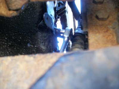

ran out of acetylene on a 3 day weekend when nothing will be open until Tuesday.don't ya love it? lol.don't much matter.i'll have it refilled and the rivets burnt out before the parts get her anyway.
wouldn't you think the rivets would slide right out with both sides burnt off with an air chisel though? oh no.couldn't be that easy lol.

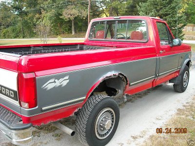

i found this truck back in '09.she looked very rough around the edges but i could see past the rusty sheet metal and knew she was well worth saving and had her whole life ahead of her still........with some love and understanding..........then the conversion to set her up how i needed it.converted to dually,sprung heavy out back,stake body dump,some fresh fenders,cab corners and a new coat of paint,you'd never know it was the same truck now.
she came from Connecticut.
from 50k miles to today,closing in towards 150k.
