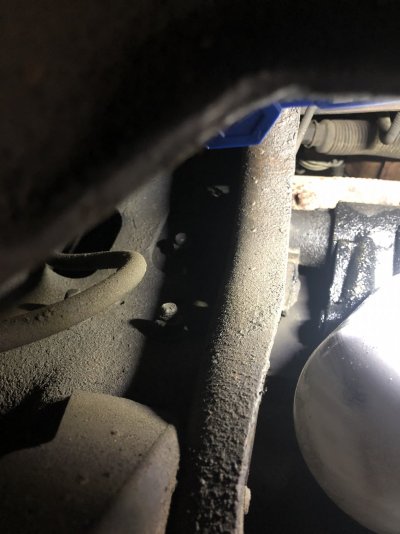

So I bought this truck in Dec so I’m a little new to the IDI’s. I’ve plumbed up most of the problems this truck has had except this one. See the pictures, looks like the oil filter leaking but it’s tight. There’s oil above it so I assume it’s the housing. How difficult of a job is that to replace? Is that even the problem? Also I drove this truck about 1500 miles sense I changed the oil in Jan. The leak was there then and it leaked only when warm after shut down. After it cools there is no leak. The strangest part about it was I never had to add any oil to the truck between oil changes. I just changed the oil again today and got 10 qts out?

I have the same issue , I replaced my oil cooler which is right above you oil filter but mine leaks where the oil cooler header meets the block. Replacing the oil cooler is a messy job. Drain the oil , remove filter. drain the coolant from Rad , theres a plug above oil filter to drain the coolant from engine. I removed drivers side engine mount bolts jack the engine up an inch put a wood block in the mount then disconnect oil cooler and slide it out the back of the engine , replace all seals and bundle if its rusted out like mine then reasemble.its not to bad but takes some time. Ford quored me $ 600.00 in labour. main thing is that your not getting coolant in your oil , or oil in your coolant. I been living with my leak for a while . Plenty of vidoes on Utube about this job. Good luck.

The mount that the oil filter goes on is actually part of the oil cooler, so if you're sure it's not a valve cover gasket leaking and running down, it could be the oil cooler gasket as described above.

It could be that the outer edge of the gasket for the oil side is leaking (hence the dip) but hasn't ruptured internally yet. Check the oil dipstick and take off the radiator cap. If both look fine, they aren't mixing.

As long as your oil is nice and black and not gray, there's no coolant in it. The coolant and oil will mix when the engine runs and turn gray. As long as you can't see any oil when you pull the radiator cap, there's no oil in there. Since oil is lighter than water, it will float to the highest point in your cooling system which is the top of the radiator. Since you didn't mention either one, then no they're not mixing. Going from your pictures, you have an oil cooler o-ring that's leaking oil externally. You will have to replace the o-rings someday. The leak will not go away on it's own. When is up to you. The oil may start leaking into your cooling system, so I would get it over with soon.
