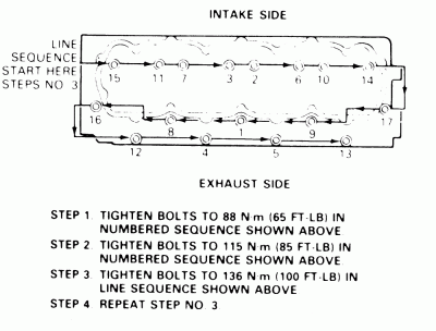

Coming at ya... Make sure you lube the threads AND washers with oil before installation if you don't already know that.

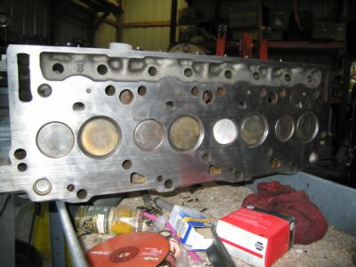

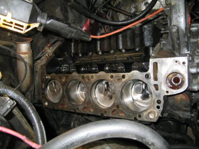

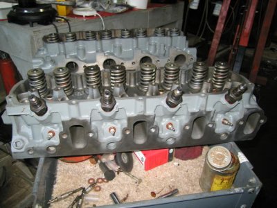

Hear are some pics of my stuff, takin my time doin it right I hope.

Nice looking work. The block is no where near clean enough for the head gaskets to hold. Use a scotch Brite pad that is used in the kitchen for cleaning dishes and pans. Then wash with brake cleaner. It wont leave any residue at all. Sometimes after I wipe the heads and block with a shop rag it leaves some threads and fuzz behind. I then use a propane torch and flash burn it off. Also did you check how much the valves are sunk in the seats? How much did they mill the heads? Head thickness is 4.795 to 4.805 and the precups are above or below the head 0.0025. Thats plus or minus 2 1/2 thousands. Intake valve is set 42 to 54 thousands below the head. The exhaust is set 51 to 63 thousands below the head deck. These are very important demensions so check them if you can. The valve rocker bolt torque is 20 ft lbs. I go to 24 lbs just because I feel better there.

Are you meaning .040" on the valve recession? If so that is not to spec. Spec is .042"- .054" on the intake and .051"- .063" on the exhaust. It looks like they used a belt and did a re-surfacing on the heads. If that is true then you really need to check the minimum thickness like Gary said since that is critical to all other parameters. Were any of the valve seats replaced? These heads should never be surfaced unless they are out of spec. (warped more than .006" overall). Lube the bolts AND washers with engine oil ONLY before torquing. Be sure you use a BOTTOMING tap not a regular tap to chase the threads in the block and blow/vacuum all the crud out.
On edit
When looking at some of the pics you posted the valve stems seem to be the same length (exhaust/intake) on one of the cylinders which is not correct (Gary can tell you all about that). I would suggest you get in there with some measuring equipment before you install the heads and maybe find a problem after installation. Do you know the experience the machine shop has with these particular heads? I just don't want to see you with a problem later on after all the work you've done.
If you need more specs let me know.

I will measure the overall thickness of the heads tonight, the new exhaust valves all are around .042-.049.
Will the thicker Felpro head gasket make up some differance?
All new exhaust guides, all new exhaust valves, all new springs, one prechamber, ground the heads just until all touched across.
