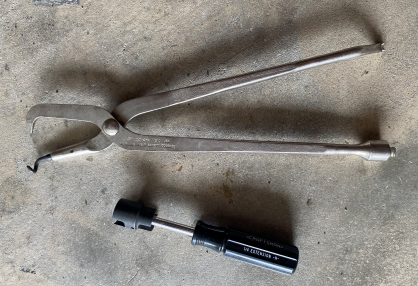

I think I have the right tools, except I need to pick up a brake spoon...

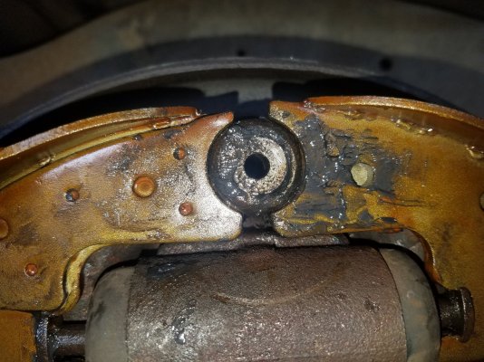

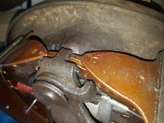

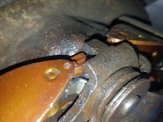

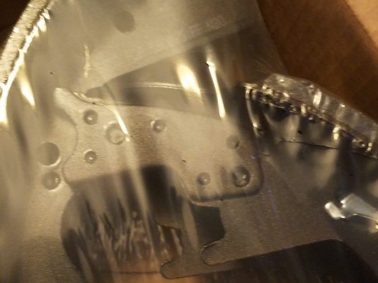

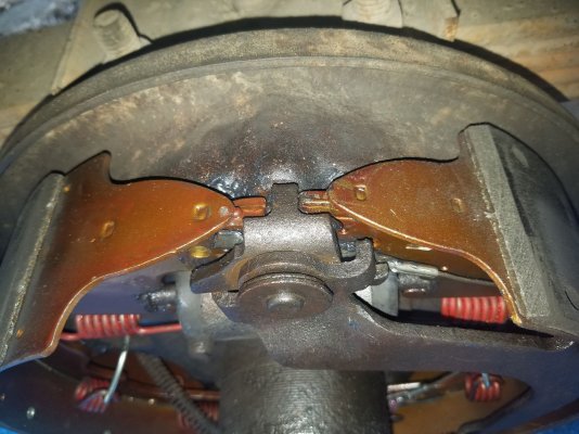

Check the shoes. some are being made wrong, expensive ones too. The gold ones are made wrong. the grabber ears are too small. the black ones in plastic, cheap O'Reilly ones, are correct. it was making the rear brakes barely work. the tab on the brake lever was going over the shoe. you can see where it took off the paint.
