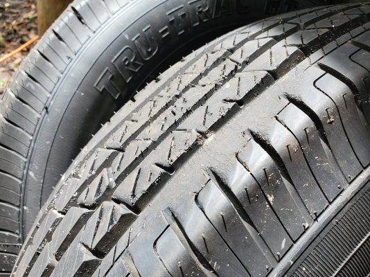

Here's the key clue: both dually tires on problem side have a flat spot. Melted.

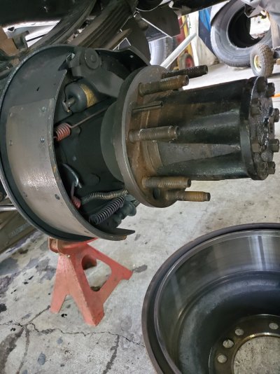

Since it is drum brakes, I am going to guess something came apart in the brake on that side.

No oil or issues with bearings or brakes.

Could a chipped tooth have locked the driver side, causing the skid and flattened tires?
Will post a pic of pumpkin.
Still have no clue where to look.

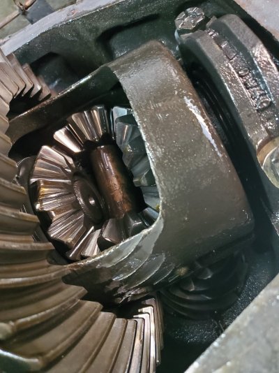

Major gear grinding...
How to fix this?
And what's the cause?
Pic is looking up and toward front of truck.

Disconnected driveshaft and removed front bearing. Great Shape.
The nut connecting the bolt to Yoke/pinion running back to gears was tight.
Remove rear axles and check the inner bearing?
Does that bearing just fail and shift rearward?

IMHO, better check the pinion again.... take it apart.
But before you do that.... Take a prybar and see if you can force the carrier left or right in the housing. If it moves noticably, the carrier bearings are shot.
