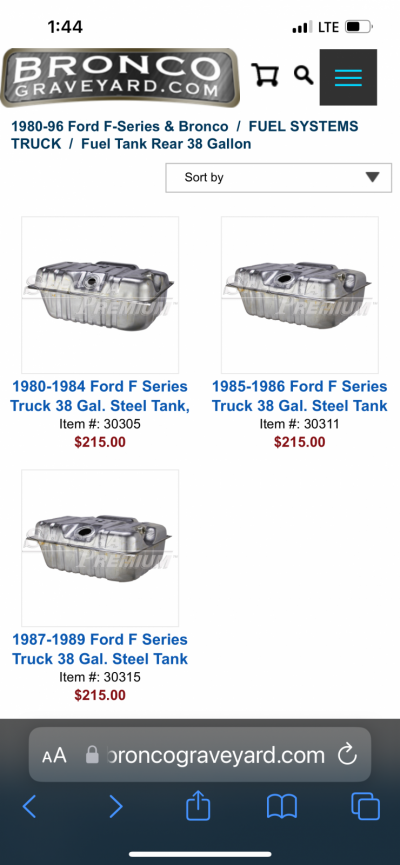

What’s the difference between 85/86 and 87/89?
My truck is an 86 but it is out of stock
1,658
1,645
Not sure with Bronco Grave Yard, but the rear tank mostly recommended is the Spectra F26E.
I used that one on my 86, fit right in
This is from the Spectra site.
Doesn`t show Diesel, just gassers.
Amazon has it for $187,
Scroll down and read the reviews, fits 86 - 97.

I think I have the top left one from your pic in the garage, I’d give it to you for $50 but you’d have to figure out how to get it
