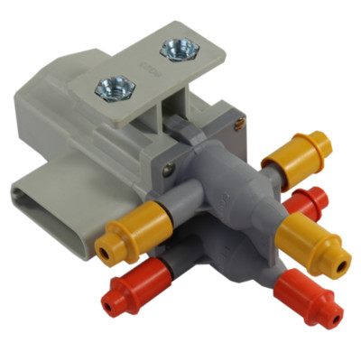

sorry, Fsv, showerhead?
can you explain those?
The showerhead is the fuel pickup located in each fuel tank. It is therefore at the very beginning of the fuel line. It can get plugged by debris in the tank.
It gets it's name from it's shape. It looks rather like a showerhead.
1,659
1,645
Shower Head is the plastic piece on the bottom of the tube that pulls fuel from the Fuel tank. Has a plastic screen on the bottom of it.
FSV: is on the frame of the vehicle on the drivers side on the forward end of the front Fuel Tank.
It is the selector valve that switches between front and rear tank.
The selector switch on the dash board controls the FSV, and switches the Fuel Gauge from one tank to the other.
Here is an example of one off E-bay.
2,305
2,335
Mind you, the light would come on if there was a mechanical issue with the shower head or the fuel selection valve. More often than not its a wiring issue, check to make sure the wire isn't rubbed and grounding out somewhere. Easier than dropping tanks.
