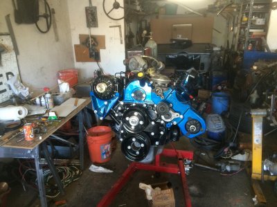

a bunch of test fitting.
notice my new turbo hat?
yea that thing dont fit.
even with trying to clock the turbo.
so im back with the old one.
save that thing for the next build...
mocking everything up so i know what hardware to use.
turns out that i have the stock rear main seal, and the sleeve type.
it pays to have extra stuff!
but uahhhh no way im gonna do that seal one way or another with the engine on the stand, i tried..lol
i wanna get all of the little odds and ends on today, so i can take them off and paint them.
gotta pull the cold side of the turbo off and have it either polished or powder coated... undecided, but a nice polished cold housing and turbo hat would look pretty slick.
no go for a pass side CDR, the dipstick tube bracket would not clear.
gonna spend the rest of the day hooking up my oven in the garage so i can get to coating the exhaust stuff.
then out to the fab shop for some work on the actual truck!
14,778
483
You ARE checking on pulley alignment right for serp pulleys? It is important to avoid belt issues and so forth ...
Just checking....pun intended

Looks great! When I got to see this motor it was all parts on a bench (or 3). Great to see it come together!
