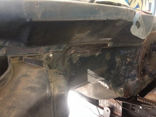

address the firewall around the clutch area, prone to cracking.
delete the firewall to floor pinchweld for turbo downpipe reasons.
i also do a little fab to the cowl so that i can pull the 093 turbo in minutes.

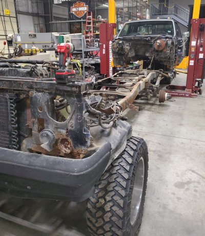

I've done several of these, my advice remove the entire cab (including front clip) from diesel truck first. Next remove all of the wiring + the dash, seats, & carpet from the gasser. Now remove empty cab shell from gasser and bolt on to the diesel frame. Swap everything from diesel to empty shell. When the shell is empty, its a perfect time to make rust repairs. Apply bedliner coating to both sides of the floor, install sound deadening materials, etc.

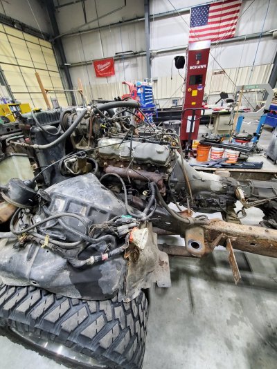

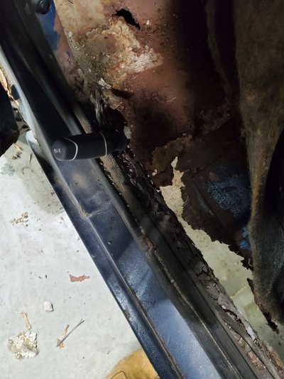

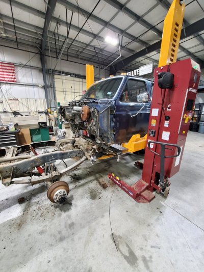

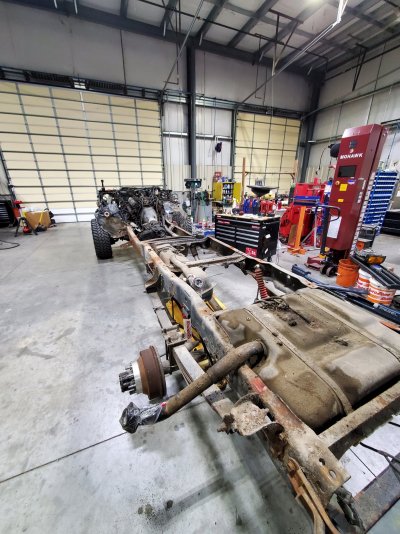

Welp...got the cab off. Going to work on the frame and replacing fuel tank sending units. Didn't realize how bad the floor pans were in the truck. Glad the gasser is rust free. Any thoughts on the throttle linkage? Will the gasser line up? I disconnected the throttle cable at the pump and left it with the cab

Pretty sure the throttle cable and pedal assembly is unique for the diesel.
