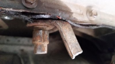

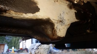

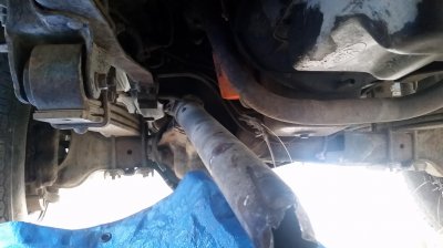

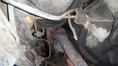

Brick nose E40D has walloed out front drive shaft...uhm twisted n took out shifter.
attachment.php
attachment.php
attachment.php
attachment.php

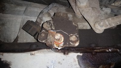

Here is what is left at trans for shifter to connect too.
attachment.php
Here is the cable shifted trans I hqve from a 92 OBS
attachment.php
I need all shift linkage for the broken one seein as the ***** got walloped out of the truck all.over the road by the driveshaft.
Can anyone help?
Thanks for looking

Anyone with a 90 or 91 E4OE truck...if you could please check a measurement for me that would be great.
From ..Centre of shaft into transmission...
To..Centre of shift pin hole on arm on above shaft...
Also pics and side profile pics would be helpful...anythin that I may use to weld up my arm to make it work.
Here is the shifter arm on shaft bent back down psuedo correctly..
attachment.php
attachment.php
This arm is NOT bolted on like most arms....there is no provision for a bolt...it appears it somehow is fused on
attachment.php
Such is the way it is....I need the c to c of what I am missing the hole where plastic bushing for shif linkage to go into sits.

E D I T
Upon many tele calls and countless part # interchanges at the local stealership...and calls to West Coast Transmissions in Tullameen...
It appears a shaft...a pan...and shaft seal will be delivered....we are hoping it is correct one...I though optimistic and excited are not holding my breath...
No taking **** appart till golden egg in hand to compare...
So pics and meazurements still please
