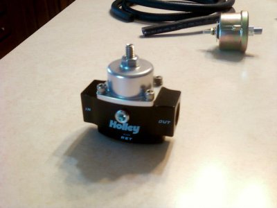

IP is done as is lift pump(leaking). E-fuel conversion and R&D IDI Performance 90cc IP time!
I am going with a new OEM lift pump found on the '98-'03 7.3L superduties. I ordered it from Strictly Diesel

What are the flow specs on that Holley? I like how you mounted it straight into the filter header, no extra brackets to mess with.

flow as in gph? i have no idea. pressure it is 4.5-9psi. 3/8" NPT fittings.
i was originally gonna mount it on the back side of the coolant filter bracket but once i got to looking at things, i realize how tight the brackets were and stuff. so i held the reg up the way i have it now and like that better.
BTW, i am going to put that plastic wire loom on all the fuel hose. need to buy some.

X 2 on the pump. Ill be real interested to see how that works. It's neat and tidy. I like neat and tidy. ;Sweet

Ah. I'm a moron. That's the regulator not the pump. So the output is 3/8 npt? Is the input just a hose barb type thing? Push the line on and clamp it? Is the regulator really necessary? I though the IP could tolerate up to like 9 psi without any major timing issues. :dunno
I still like this.

Are you concerned that the pump may get hot? I guess it shouldn't but you are returning a large amount of fuel if it is supplying at 60 psi.
Still intrigued. Let us know how it does once you put a few miles on it if you don't mind.
