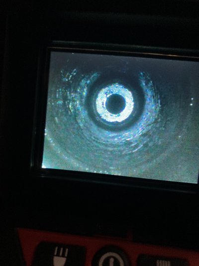

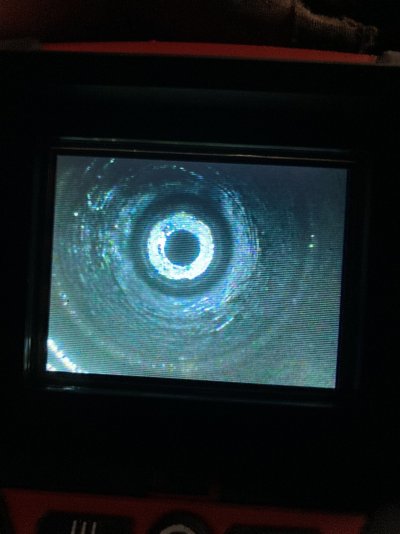

Eureka! That injector bore was a complete mess as expected... obviously there was a seal issue first time around.

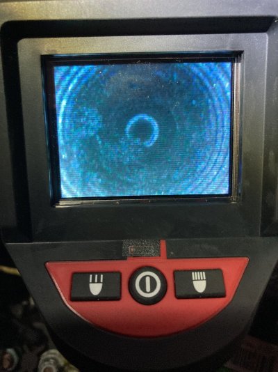

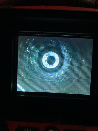

So I used my shop vac with a 6’ length of 3/8” fuel line wrapped in a rag to plug the vacuum hose and created myself a 3/8” shop vac hose and sucked all the big chunks out, then sprayed some blaster around the threads and then sucked that out after about 20 mins so it could to do its magic. The bore and seat cleaned up surprisingly well. Unplugged the runaway kill circuit on the IP and ran it on starter with no fuel for a few turns to purge any goop or blaster that got through. Injector is back in and seated with a new seal, return lines hooked back up and voila!! Thanks again...!
Hate to say it, but IMHO the sealing surface/seat still looks not that great. Looks like some pitting in the borescope picture. This is what mine looked like when I had a leak. Carefully reaming the seat with an injector seat reamer finally fixes the problem for me. When done I had a smooth seat with not pitting or carbon buildup.
You might still have a leak, hope I'm wrong.
