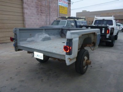

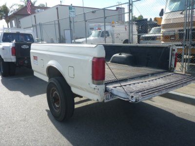

i started with the blue boxed trailer which had a pickup DRW axle under it.
I removed the DRW box and mounted a SRW box and SRW wheels.
it's noticeable but not the end of the world bad.
hope this helps.
