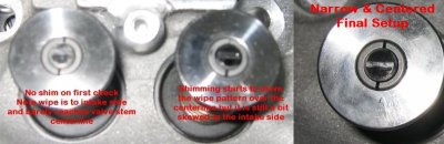

I use bearing grease to check VTG
remember Al, I have roller rockers and custom pushrods

The last cam I ran on an ls1 engine was . 651" lift. They have to grind the cams on a smaller base circle to get the extra lift and still slide through the cam bearings so you usually have to run longer pushrods. I always checked wipe pattern to make sure I had the right length pushrod. The stock rockers are non adjustable. It's amazing how much 0.010" can make in the wipe pattern
