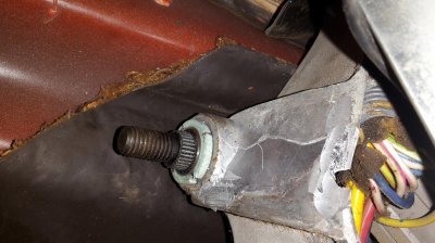

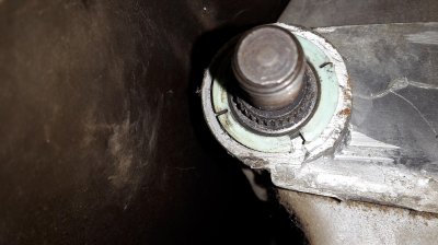

Not sure how to properly upload from a smartphone. Hopefully this will eork

It looks like bracket is broken...from the first image but on phone cannot tell.
As for TO it shoild be on bill if replaced.

The brackets not broken. It's was modified with a heim joint because it was worn. Tb was not on the invoice. Can't understand why they wouldn't replace that since we're in there anyway
You need new something - either clutch pedal or MC lever, depending on which side of the bracket this picture shows. I'm thinking it's the right side of the bracket, and thus it's the pushrod lever that's missing and had the splines worn off.

The splines on the shaft look and feel ok. The bracket is shot. I do have another but it'd back home
