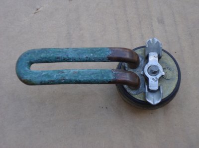

This is what it looks like on the back side. The T bar holds it like a toggle. The Screw that holds the bar is not supposed to come all the way out. As you turn the screw it will start getting harder to turn when you reach the end of the threads. If the screw comes out the T bar will fall in the water jacket. It may break in two and fall in. You can fish it out or leave it if you can't get it. I bought a Zero Start from O'reillys that looked like oem. The Kats one NAPA sells didn't want to go in without bending the element so I returned it.
Edit: Right click on pic and select view image. I don't know how to resize my pics.

so i got it out. and the original one is much shorter then the new one. the copper conductor that is. will that be a problem looks like same plug size
truckermark
her names birtha
May 20, 2014
152
michigan
lookin at them. the smaller one is only 600 watt... . will this be efficiant enought? its the only one i could find
TahoeTom
May 19, 2010
749
113
S. Lake Tahoe, CA
Did you check O'rielly's? I got the 1000w Zerostart from them and the element is long like the one you removed.
