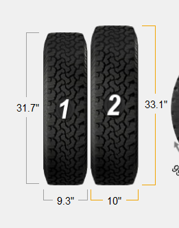

I've read here that 33" are fine on a stock F250. But is it ok to also go a bit wider?
I have stock size 235/85/16 on there now (#1). I have a chance for a good deal on 285/75/16 (#2).
Good to go?

Will make brakes less effective, to a bit of an extent, will not help mileage, will not help power, will make it more squirrely, and, could even have issues with tires rubbing on frame. 33s are about as big as I would go. Wider tires will help braking, and handling, as long as you don’t go crazy wide, then you will have rubbing issues…
I currently have undersized tires, 28.5”, and next set will be around 32”

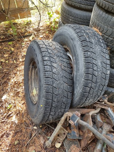

255/85R16 is a limited selection, and less load capacity than the common 285/75R16.
Here's my old pair of 285's I ran for the last 10 years... with a locker. Wore them about as evenly as possible by playing with the tire pressure. (On ford 16x7 wheels.)
